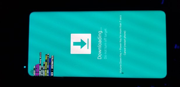

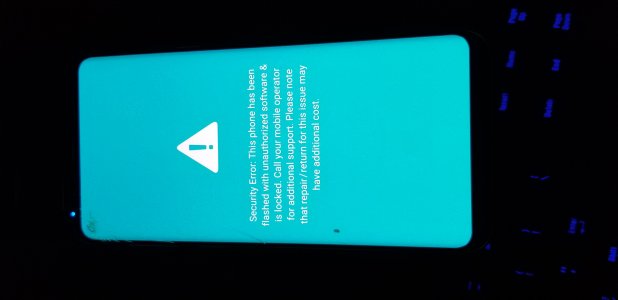

I woke up to my unresponsive s8+ phone. Black screen and power button didn't work. I performed a soft reset (power + volume down button), phone rebooted, but never to my home screen, just the Samsung title and provider screens. After multiple reboot attempts, I receive a green screen with the message: ""Security Error: This phone has been flashed with unauthorized software and is locked. Call your mobile operator for additional support." I've been checking this forum for assistance but unable to figure out how to get the firmware I need for my phone using Odin (which I have installed on my PC - Win 10). I visited sammobile but US is not listed under Country/Carrier. Please help if you can. Thank you.

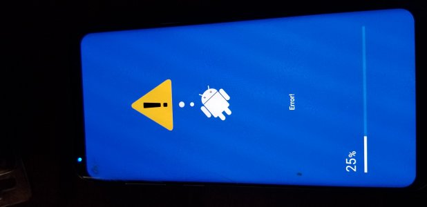

Thank you. I successfully loaded the correct BL, AP, CP and HOME CSC files into Odin, ran it, and log indicated "All threads completed (succeed 1 / failed 0)". Phone rebooted, I received the blue screen "Installing system update", then the screen went black. I pressed the power button and nothing happened. I did the soft reset and the blue screen appeared again, droid displayed the swirling circle, it was moving, then stopped, and screen went black.

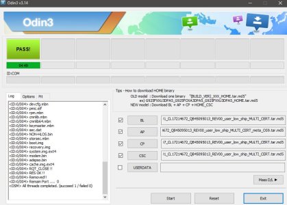

So you using a knon Good cable ? Try different port on computer , odin needs to say pass so it didn't load , which odin version?

Yes, I'm using a fairly new ANKER USB cable. Odin did show PASS. Using Odin v3.14.

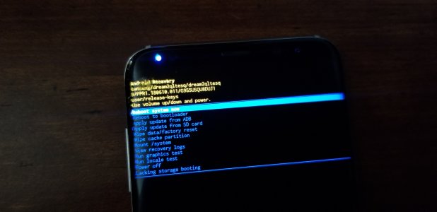

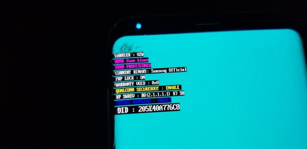

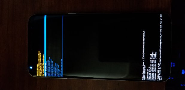

Thank you and MNMobileGuy greatly for your assistance. I was hoping for a better outcome. Love this phone. But I don't have AT&T as shown in the screenshot below. I thought I was required to d/l the file my specific carrier?
All US carrier firmware are interchangeable
If it won't boot up, you'll need to do a factory reset from that menu
He should of never used Home CSC when phone in the State
And why not? It's not going to hurt anything. It's a pain in the butt to have to set your phone up again. So it's worth it, to avoid the factory reset. And then only do it as a last resort, if it's absolutely required
Because your not trying save data as you would doing a update , the phone is bricked needs everything erased from beginning .
