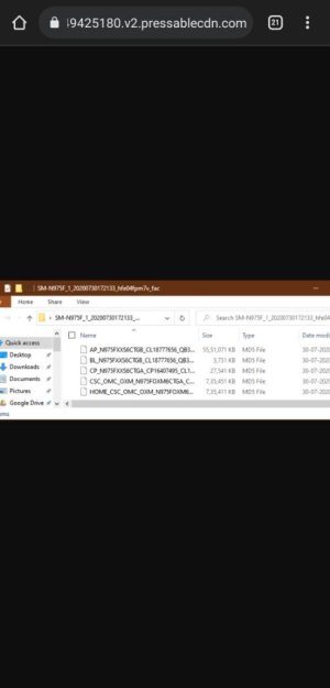

thanks for the swift reply. It seems like the zip file only contains one big file with md5 extension, what I did was I changed it's extension to zip and was able to view files inside. But, they're more than 5 files and aren't the (BL,AP,CP ...etc) files?
No problem
Where did you download the file from?
You use a program like 7zip to extract?

I assume they separated the file to these files with the newer devices, mine is old. This is the only logical reason I can think of.
What Andriod version its on ? I can't confirm as I don't have a device that old to check

weird, so does this mean I downloaded incomplete firmware? The tool is designed to grab firmware from Samsung servers, it was suppose to download it directly from there. Should I download it from somewhere else?

Frija is where i download my firmwares, something your missing when you extract the zip file , can you explain step by step how your doing it?

I simply put my phone model SM-N920C in mobile model box, my country code in CSC box and ticked the auto box and clicked download. The firmw was downloaded and automatically decrypted. I extracted the file and it had only one file ending with ".._HOME.tar.md5" I added ".zip" to the end of the file and the pic above was what I got inside :\
