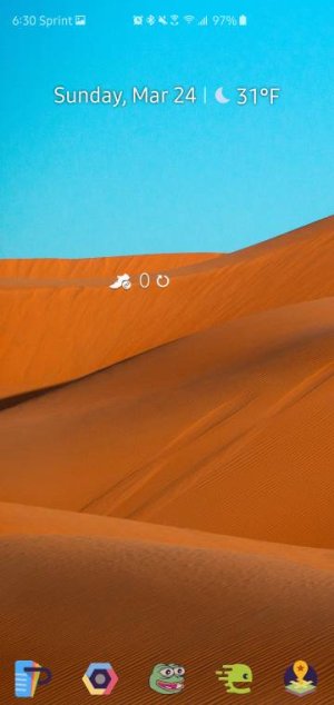

So, I always used Samsung pay on my Note 8 and I could quickly access my favorite cards by swiping up from the bottom of the screen. I could do this when the screen was off, from the lock screen or from my home screen, that little Samsung Pay "tab" at the bottom of the screen was always there.
One of the first things I did with my s10 plus was set up Samsung Pay and I quickly noticed that the tab at the bottom of my home screen disappears. I have favorite cards turned on and I can swipe up from the lock screen or when the screen is turned off but not from the home screen.
Any others experienced this?

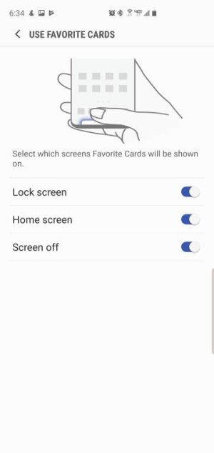

I can't tell from your post and assume that you have the proper settings enabled.
Yea, I have all the correct settings. Funny thing is, I can toggle the favorite cards in Samsung Pay and the tab will appear on the home screen for a bit, then is disappears.
Sounds like a Nova compatibly issue.

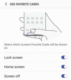

Just curious are you using this gestures for Samsung pay ? I circled it
Yup, I came here searching when it disappeared on my s10e after installing Nova launcher. But Mustang's suggestion got me to take a look at my Nova launcher gestures and assign two finger swipe up to Samsung Pay. It doesn't automatically go to the card as in Favorite Cards but in some ways it's better as I've had accidental favorite card swipes previously. Thanks Mustang!
