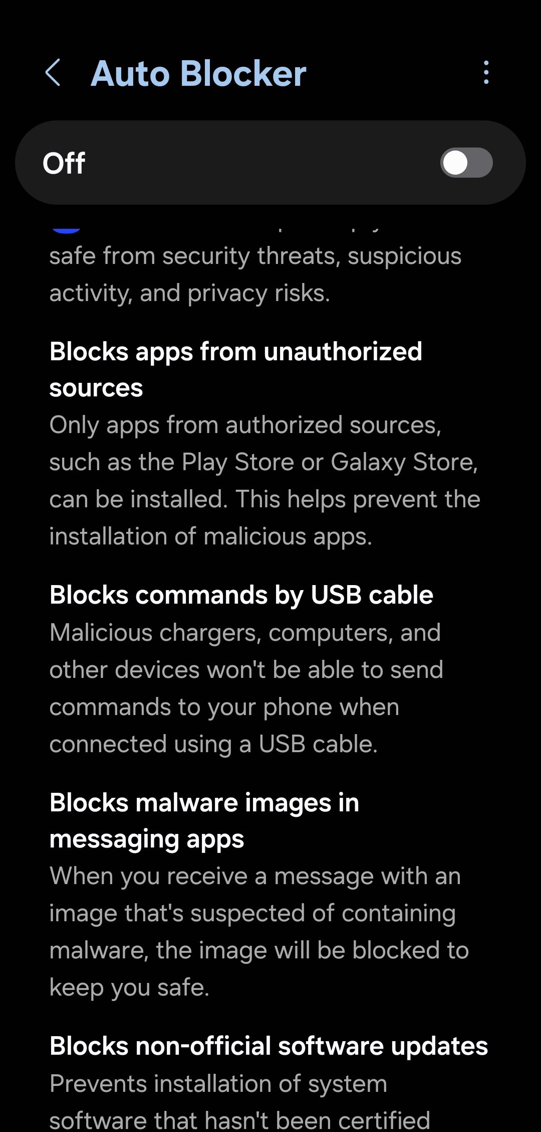

Check one more thing
Settings>security & Privacy>Auto blocker on?
