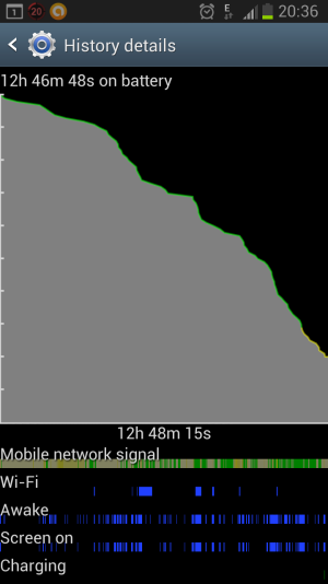

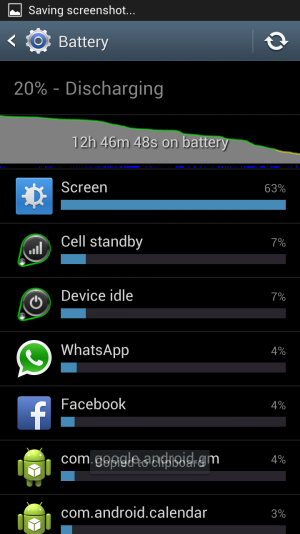

Hello,

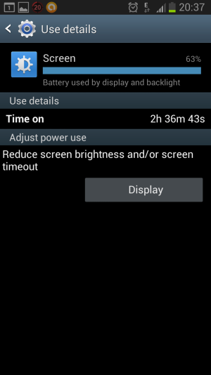

I use my S3 for Normal usage (whatsapp mostly, maybe surfing a bit thru facebook and the occasional website on the opera explorer). I dont use it for anything else, and I notice that the battery lifetime rarely exceeds 13h.... is this normal? does it really last half a day? here are some screenshots (notice the screen on time... just 2:36h...)
Just wanted to hear some opinions on this...
Thanks

That doesn't seem unusual for 2 1/2 hours of screen on time, combined with a fairly week signal much of the time. The screen accounts for most of your battery usage (63% of the charge used so far, and nothing else is using a lot of battery. About all you can do is turn the brightness down, and if you have a wifi signal available make use of it.
^ Agreed - this looks pretty normal, especially since it looks like you're on a mobile data connection (running Edge speed?) rather than Wi-Fi.
Your Awake events track to your Screen On events pretty closely, so I don't see a problem there.
Cellular signal is somewhat marginal - you could use GSam Battery Monitor Pro: http://market.android.com/details?id=com.gsamlabs.bbm.pro (there's also a free version) to look more closely at the Radio Detail if you were so inclined.
