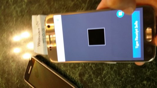

Hi, 1 week ago I bought my galaxy s7, and now I downloaded walmart app, when I try to scan the Qr code the camera no show nothing, is in black, no scan. I try to open the app whit my tablet samsung and scan and yes! Is working very well the app, I try to download the scanner app, and the app work, but with the walmart app no work, what happens?

Yes the camera woks very well with the others scanner apps.
The walmart app I downloaded from play store on my s7, and I try uninstalling the app but when download again it's the same, not working.

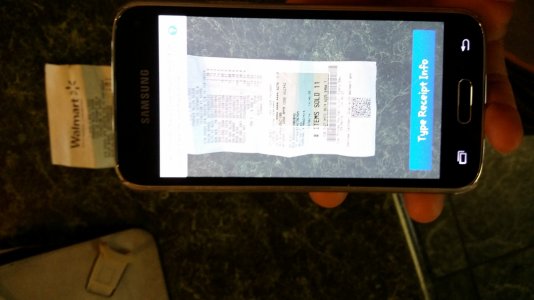

When I try to scan, I can't see nothing in the screen, normally in the tablet and my old phone, s5 mini, I I cat see the Qr code, like a camera, o see the table, everything, but in s7 nothing!
Possibly the app isn't updated to the latest version of Android, or to the S7. Tap where it says "Type Receipt Info" and type it in.
The same thing is happening with my samsung galaxy S5 so i dont believe it to be an update issue.... i didnt have this issue before but started doing this about 3 months ago . I type them in when using saving catcher but prevents me from using walmart pay altogether funny thing is that any other qr scanner i download functions perfectly... camera works perfectly without any issues it is just that particular app it dislikes so i believe this is a walmart app issue for the majority of the samsung line?
