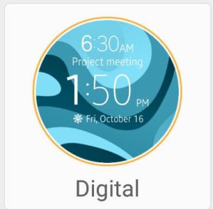

I am using the one called digital that comes preinstalled either on the watch or on the gear manager SW. Just set complication 1 to schedule.
Just added a 7pm event for tonight, and it's listed as 8am on my Nexus 5 using the Digital watch face. Bummer.
