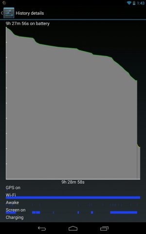

After a week of behaving itself and being unlocked and rooted, I wake up this morning to find it unresponsive and battery about 45% lower than when I turned in. Since it had to restart GSam can't give wakelock info. This isn't cool. I wonder if I need to exchange it? Bother.
Sent from my Nexus 7 using Tapatalk 4
