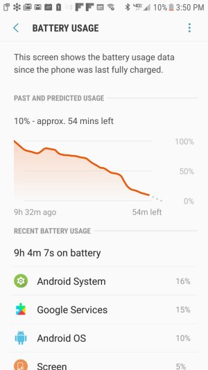

I have the same problem. This started only recently for me on the Samsung Galaxy S7 Edge with AT&T. The screen will keep coming back on with the notification every 5 seconds and the battery getting drained.
Somehow it appears that this is related to my Samsung Pay account but I can't figure out how/why. I don't think I installed any new app recently though

https://forums.androidcentral.com/s...k-while-calendar-notifications-displayed.html. Turning off credit card "favorite" fixed the "hot pocket" problem for me. You can see my battery dive-bomb simply from a calendar notification that I did not notice. The phone would be hot, and I would lose so much battery during the day I bought batteries and would have to charge some time every day.
