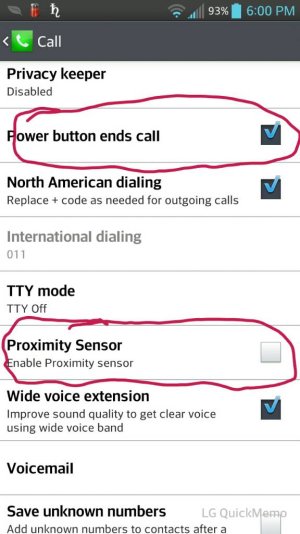

Hi. You could try to Uncheck the proximity sensor in the phone settings. Also select "power button ends call" and see if it helps. Let us know.

Go into the phone settings (or maybe access the settings from the dialer with the dialer app open) and turn off the proximity sensor. Then select "power button ends call". That should hopefully help. Let us know.

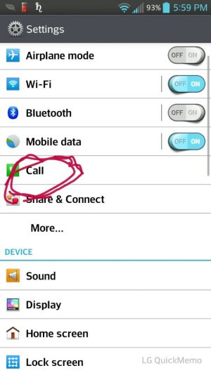

Can you take screenshots of your phone settings page? Here's what I see when I look at System Settings on one of my phones, it will look a little different on yours but you'll have these similar options somewhere.
Sent from my LG870 via Tapatalk 2

So, in your phone's settings, you have no options like the ones I described and in my screenshots?
