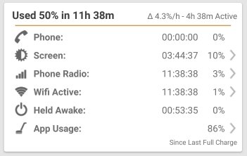

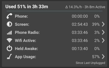

Back in May, I wanted to see how far I could do on a full charge... No idle, just stay on the thing until it hits E. That magic number was pretty much 6:00 on the nose. It hit 6h, touched 5% then warned me it was shutting down. So that was pretty much my max... 6 hours. Not bad since I am never usually on my phone for that much on any given day.
Within a day or so of loading 6.0, I noticed a sizable bump in my battery life... about 12 hours off the charger, I was at 50% and showing a good 3:44 SOT. My internal calculator rang some alarms and I went back and found a GSAM snapshot of nearly the same point during that 5.1.1 6 hour endurance run... Now, my usage on these two occasions was pretty much exactly the same... On a group Hangout, G+, some forums, some web. No games, GPS work, etc. Just 'wastin' time' mode. It was night both times, so the screen was maybe at 1/3 or so both instances.
5.1.1
6.0
The difference is pretty striking. On 6.0, I'm 50 minutes ahead of where I was on 5.1.1. In and of itself, that's a good bump. But when you factor in that this also came over an additional 8 hours of time. Safe to say that Google had some last minute power fixin hidden up their sleeves...
