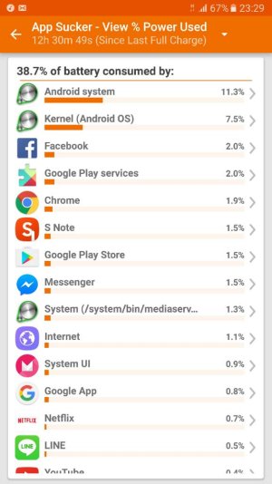

Do a screen shot of your battery usage. Let's see what is using your battery power.

The biggest battery drainer are the screen and the android system
Posted via the Galaxy Note 5
Here is the normal screen
Phone Radio % is one of the higher values. If there is poor cell signal, then that could cause the radio to work harder to get/maintain a signal, and in turn use battery. Within the GSam Phone Radio details there are more "Usage Details". That may provide further clues.
