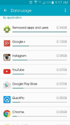

How did they figure out it was the cloud. I have major data use too but I figured facebook might be the culprit since I never set up the Verizon cloud.
Hey Kirk click on setting button in your apps selections page. Click on data usage, scroll to bottom of page. Apps and bar graph of total usage clearly presented. Awesome for me since finding this.
Can you please show screen shots of how you got there. Thanks!
This is how I found out about Facebook app using almost half a gig in just a few days. I'm at a gig of data use after one like 5 days into my plan. Cloud isn't showing very much data. Using Facebook via the browser now.
