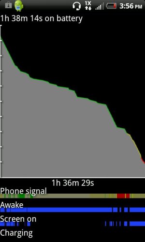

My Phone life resembles a fat kid in a triathlon. Seriously on a full charge with usage such as average web surfing and text messaging, i can expect my phone battery to last about 3-4 hours. I have tried replacing the phone battery, as i now have about 3 or 4 "OEM" batteries that i have purchased from ebay to no avail. My phone takes about 4 hours to charge, and appears to die at a faster rate than charge. The expectation of playing a game on my phone is out the window. I literally carry a phone charger with my everywhere i go, and i expect to have to charge my phone atleast 3-4 times a day. I have tried advanced task killer to little avail, i have deleted applications that appeared to be using the most data, such as facebook, to no avail.

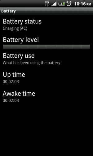

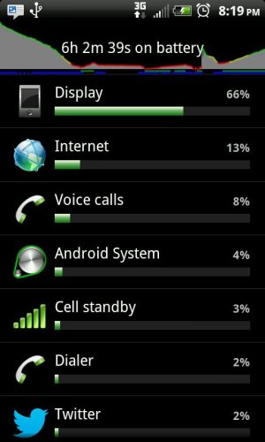

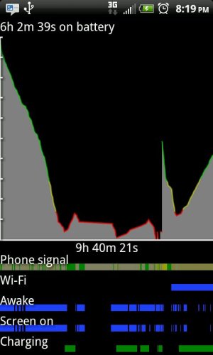

I attached four images that may assist, if not just show my serious inconvienience.

You've got a wakelock issue. Your "Awake" time is too high on the top right image. You just need to pinpoint the app that is keeping your phone awake.
