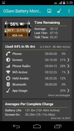

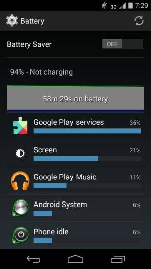

My phone always freezes, ram is always 500-700, overheating battery, no status bar or buttons and constant reload of whole homepage, I just need help!!! Any advice is great!!!

Yes at least 5 times!!! Should I just call in for a replacement and not update to KitKat 4.4.4 and stay on 4.4.2 when I had great battery life, or wait till lollipop ota?
Do a cache partition clear and factory reset. Then install nothing, activate nothing, other than the absolute minimum you need. Go into "Settings -> Accounts -> Google -> your account" and uncheck all the services you do not use. Do not activate Google Now.
Use the phone for a week and see how it does. Then, assuming it works well, you can start adding things back.

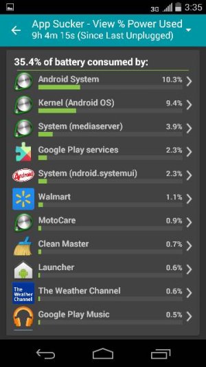

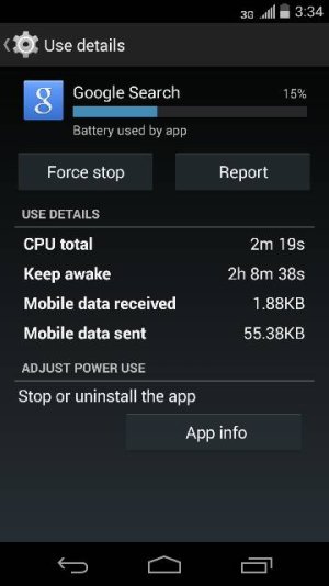

I agree completely with Old Stoneface tips. Google Search is using a lot of battery (Google Now?).
Your battery stats are not good at all and with Moto G you should get 5+ SOT without problem. Your phone is awake most of the time, that means some app is running wild.
After the reset forget apps like Clean Master or Weather Channel widgets and try to restrict sync/upload settings in apps like Google +. For example, sync just when on WiFi and the phone is charging.

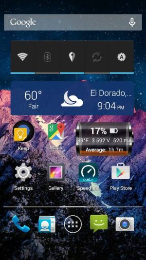

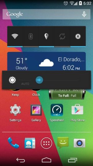

About the status bar and buttons disappearing. I see you're using Power Toggles, make sure in the settings that "immersive mode" is unchecked.

I agree about the Power Toggles tip. Think that's what is getting you there.
Also, what launcher are you using? I can't tell if that's stock or Google Now. If it's Google Now, I've found that it's incredibly laggy on this phone due to the 1GB RAM. Constant reload after almost any app load and minimization. Use Nova Launcher or stock.

Power Toggles is the app for the switches widget that you've got below the Google search bar (WiFi, screen, mobile ...). Open the app drawer, look for it and open. Tap on settings - Toggles settings - immersive mode. Uncheck the two options.

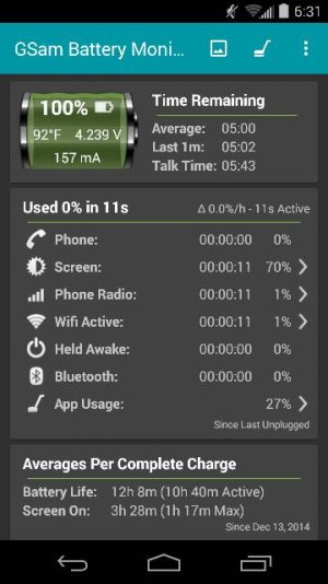

I don't like battery saver apps or task killers. I think the do more harm than good. Most useful things you can do from the settings. If you need better battery stats, Gsam could be the best option (I can see you have downloaded it already).

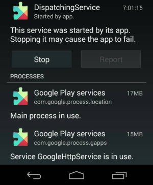

I don't know why the rest is happening, I'd have to have the phone on the bench to find out, but your phone is awake almost 100% of the time. Install Wakelock Detector (read Wakelock with non-rooted KitKat first) to see why, then address those apps that shouldn't be waking the phone constantly. Fixing that may fix other problems.

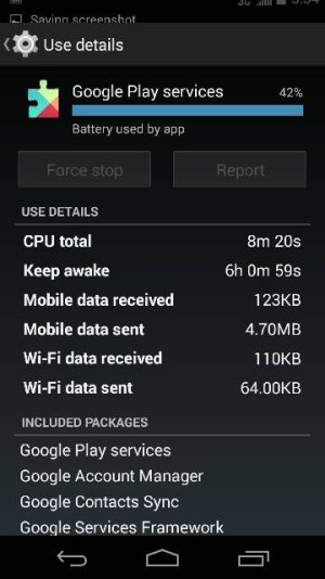

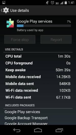

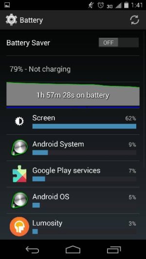

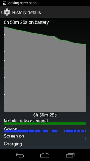

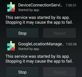

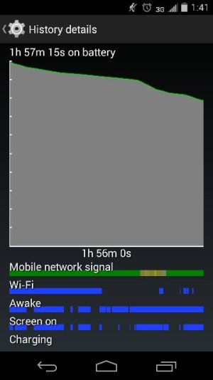

I still get this!!!

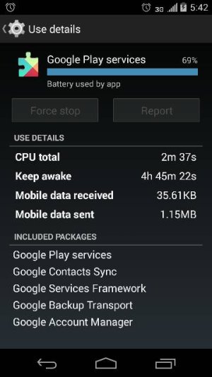

There's something weird in your screenshots. You said that you only use WiFi and that you didn't activated the SIM card (or the data plan). In the status bar just appears mobile data (3g) and network signal. In the graph the WiFi bar is missing.
And all data used by Play services is mobile!!
That's because my WiFi wasn't working and I forgot to put it in airplane mode when I went to sleep. And it seems it only does it when I'm off WiFi and mobile data is on and airplane mode is off guess it must be a bug? Anymore questions because it frustrating!!

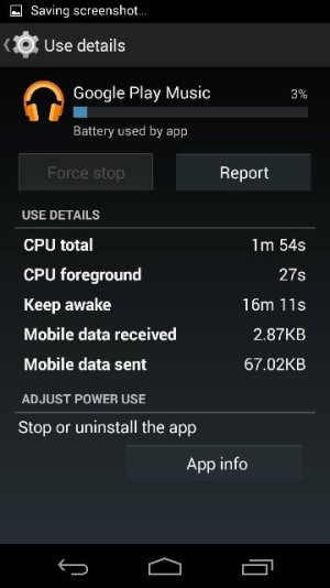

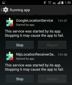

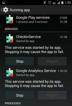

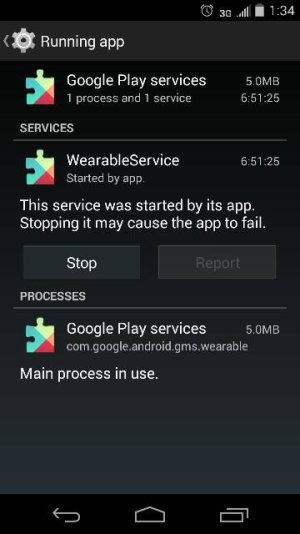

And this is what's running my battery down!!!!

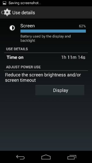

To have better battery readings you should wait until the charge left is about 20%.
After a quick look I can't see anything wrong in your screenshots. You have used 21% of the total charge and that gave you 1h 11m of screen on. That's not so bad.
