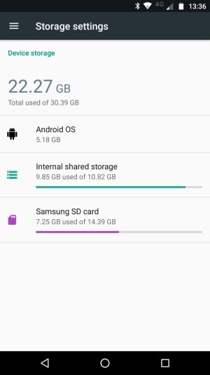

I have a Moto G4 with Android 7.
At some point in the past I copied a lot of my apps to an SD card.
I wanted to copy some more but couldn't remember how i did it.
I went through Settings -> Storage -> Internal Shared Storage -> Menu option "Migrate Data".
I suspect this tried to copy data back from my SD card to my internal shared Storage.
After a while it returned an error saying it was full.

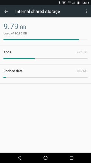

When I now go to Settings -> Storage -> Internal Shared Storage, it says 10.12GB used of 10.82GB (I have cleared a little since.) It says Apps is 4.75GB and Cached data is 32.39 MB.
I have deleted a load of stuff to get it down to 4.75GB but the system still thinks the disk is full.
I have rebooted the phone and run cleanup programs and file manager apps. It seems the file manager apps can only see the SD card. None will let be browse the internal Shared Storage.
It was only after I deleted some more apps that I could install new apps. The phone thinks it is full.
How do I free up the Internal Shared Storage.

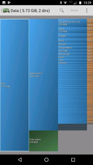

Sorry for the delay in updating. I have deleted some more apps which means the numbers are slightly different but it still appears there is some storage gone missing.Screenshot_20190311-131524.jpgScreenshot_20190311-132912.jpeg
One is of the userdata partition, the other is of internal storage, all partitions added together. You can't figure what "should be" by looking at what's being taken up and subtracting that from the advertised space on the phone. That space is partitioned into anywhere up to over a dozen partitions, depending on the manufacturer, but you get only one of them, userdata, to use for "internal storage". It can be 90% of the total, it can be 10% of the total, depending on the phone.

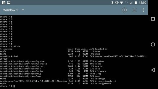

If you install a terminal app, so you can run Linux commands (Android is an app running in Linux), you can run the df -h command to see where your emulated storage partition is (look for the word "emulated" in the partition's name), how large it is, how much is on it, and how much is free.
