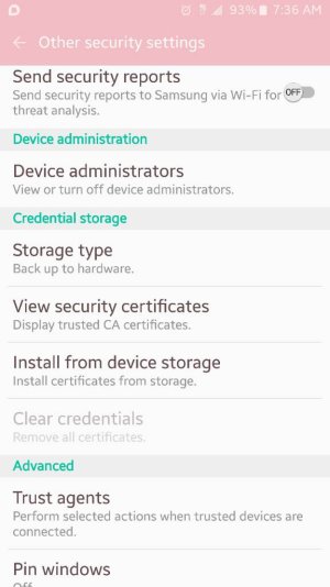

Go to Lock Screen and Security, then Other Security Settings, then tap on "Clear Credentials" then you can change your unlock method.
Yours won't be greyed out like mine is. This happens sometimes when wanting to change from a secure lock to an unsecured and you have to clear the credentials when it happens.
