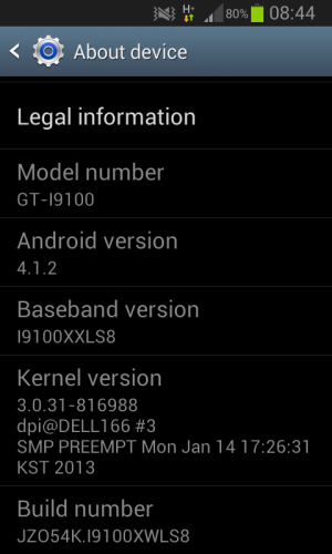

Hey gang,
Just wanted to share, I installed the official 4.1.2 firmware released in Spain yesterday from SamMobile's site. Works really well, no glitches, very smooth. I'm with Virgin Mobile Canada. It was one file flashed with Odin, no data wiping.
Here's the before/after:
SGS 2 (I9100M) on stock 4.0.3(not rooted) ==> 4.1.2 :)

It's good to be very careful, I always only flash it if I can afford to loose it.
No changes were done on my part.
I read that you can just download the file and flash it using the pda part of Odin, and it works since its not a custom rom. I'm locked to virgin btw, that did not change anything for me.
Steps that worked for me:
Download file from sammobile and unzip
Download and install latest desktop odin
Put phone in download mode by powering off, then holding volume down, power and home buttons together.
Connect to USB
Add the unzipped file from sammobile by clicking the pda button then press start after it validates the file.
Here its a good guide:
androidfirmwares.net/Guide/Details/2
