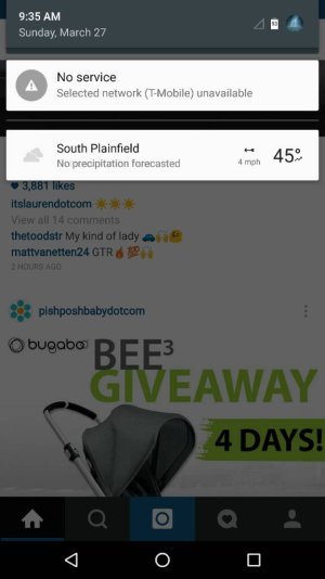

I'm in NJ and on T-Mobile and recently I've been having an issue when I'm on mobile data only with Wi-Fi turned off and my signal with go from full LTE to completely gone and I'll get a notification telling me that I've lost service. Also, when I make a call, with Advanced LTE enabled, I drop down to H during the call. That never used to happen. I'm on the most recent build and security update. Anyone else ever experience this?
I might add, the signal will drop, alert me of no service, and then reconnect all within a span of 10 seconds. Anyone else?

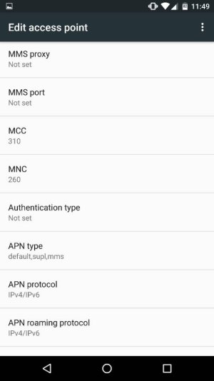

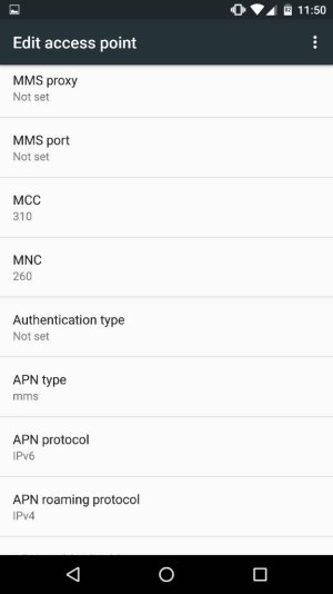

OK, I just did this and it fixed my issue. I rebooted, went to cellular settings and toggled off and back on Advanced LTE, then searched Network Operators and chose Automatic. Then I reset my APN to default and made the proper adjustments and I'm back in business. Phonecalls stay on LTE and haven't dropped out. Also, everything seems much faster.
