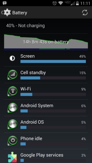

I'm also concerned with "cell standby" chewing up battery. I relate this to a poor signal as I never saw this in the apps using battery. If it was there on the S5, it was at the bottom and definitely was this much. Mine shows 18% of battery consumed. If you have better signal than me, is yours typically this high?
