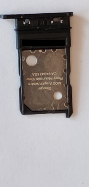

Look carefully at your tray and compare it with this image. Is everything the same? Focus on that rim that juts out, which I think is there to catch a spring mechanism -- if it's missing or worn down, then it's probably not catching.

Ah! Many thanks. It looks like the bottom (or top? Guess it depends on your perspective) was bent a little bit. I don't know if there's an obstruction or something inside the phone that is causing this or not.
Before:
I tried to straighten this out some:
It fits much better now. Still don't think it's completely flush - but a lot better now. Might just wait until I get the case now and see how that works. If not I might try purchasing another sim tray like you suggest.

Great! Maybe it has to do with that protruding "nose" at the bottom of the image -- if it was slightly out of alignment, maybe that's the thing that wasn't catching.
