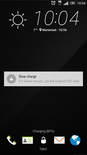

Every time i try to charge my phone i get this message: Slow charge for faster results use the original htc charger.
When i connect the phone to my computer it dont recognize it all, i get the slow charge notification all the time,
I have replaced the usb charging dock but the prob still remains, do i have to replace something more?
Can it be tha battery?
I have a new genuine charger, i have tested with several chargers.

Sounds like you have a data port issue.
You can try to clean it, maybe an old toothbrush and some cleaning solution.
If that doesnt ifx it then it needs to be replaced.
I had the exact same problem. My m8 was under warranty so I sent it away. They had to replace my battery and mother board.
