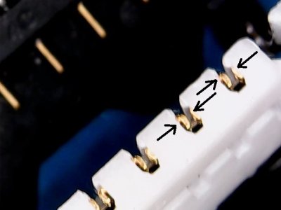

Then, second do this to your battery, most Samsung batteries have this loose connection: adjust the battery cable tips closer

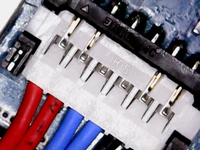

This is an example of bad contact, too pins on the left sit in the middle of the opening of the cable

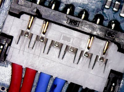

This is a good connection, pins and cables have good contact

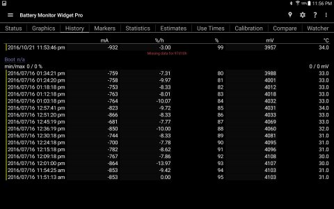

I have some used batteries full charged few months ago but when I need to use them, none is dead or lose much charge. Here is the Tab Pro 12.2, turns on after 90 days, it is still at 99%
