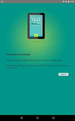

I just paired a Bluetooth headset with my tablet. Enabled the security. It definitely requires the device to be connected continuously for it to auto unlock. When I switch off the headset, it falls back on security, face unlock FTW
- Nexus 7 (2013) on Stock Lollipop
