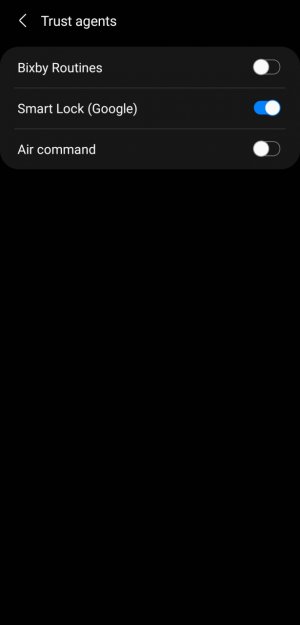

Another thing to check
Setting>biometric and security>other security>trust agents turn off anything besides GoogleScreenshot_20210522-192846_Settings.jpg
Setting>biometric and security>other security>trust agents turn off anything besides GoogleView attachment 334205
I came across Trust Agents in another Tips article the other day. Smart Lock was/is the only one turned on. Trusted Location still not working. Even reset location again in Maps. I think it is hopeless. For whatever reason they cannot get that feature to work properly. Trusted Device is working which is good but would really prefer Location.
Wonder if it gets updated in next software , report these things in members app
