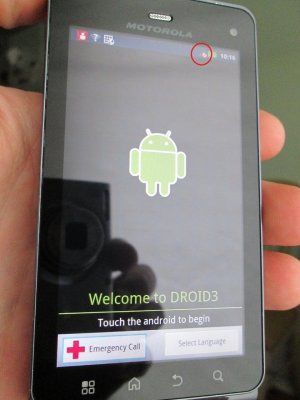

So I decided to join the smartphone world (my old dumb phone is crapping out) and decided to buy a used Droid 3 on ebay to get me to my update date (next may). It seems like a really nice phone with a clean esn so I bought it. It shows the "no service" cirlcle over my bars from the get go, and with countless attempts with verizon (in store and tech suport) I have not been able to activate it because of its no service state. I have bluetooth connectivity and wifi, so is there any ideas what to try? Hopefully I will be sending it back (the Ebay listing said no returns), but if not could I take the back off and make sure the antenna is hooked up? other thoughts?

Yes it is a XT862 and it is currently running 5.7.906. One other odd thing, from the original droid startup screen it doesnt do anything unless you bypass it (dont know that it matters) $T2eC16dHJHYFFk(lFg5bBSMPmzIhG!~~60_57.jpg this is my no signal problem!!

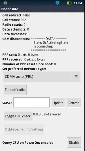

a few things can be tried.
dial *#*#4636#*#*
select Phone information
scroll down to options just above smsc: box
it should be CDMA auto (PLR)
and Turn off radio
if yours is different, correct settings and press home button, may want to reboot.
if settings are correct, I would reflash the firmware
2 options
1. download 5.5.1_84_D3G-66_M2-10 Blur_Version.5.7.906.XT862.Verizon.en.US and RSD Lite
and follow my instructions Flash xml recovery files (Stock Rom) with RSD Lite
or
2. .906 1_click sbf .exe
either method should work, if it's fixable.
Where it says CDMA auto (PRL) mine says unknown and when I change it it goes right back to unknown. Also not to seem like a major novice but how would I get the files on your link onto my phone? Thanks for the help.
