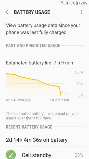

I have Samsung A5 2017 for about 3 years now. This year I noticed it started shutting down sometimes despite having battery life still. You can see that here where battery life goes from about 45% to the bottom:

The battery is most likely worn out and needs replacement. I don't think replacing it should be too expensive, and it would give you better battery life. It might also be giving you a wrong battery percentage, which would explain why it shuts down at 45%.
I saw disassembly video of that model. A heat gun is required to loosen up the glue around frame to take it apart. I don't have heat gun though.
Unfortunately, then you're looking at getting a new phone.
