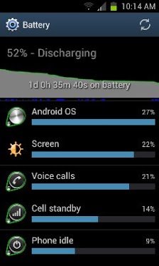

Immediately after latest update I started having issues with battery. The charge wouldn't hold more than 7-8 hours. I hard reset this past weekend and removed the memory card. I also did not reload applications and turned off sync, even on gmail. See the attached battery report for this morning. I couldn't believe it this morning when I saw I have over 50% battery and just over 24 hours of light use.
It has to be one of the applications draining the battery. Can someone help isolate the problem.

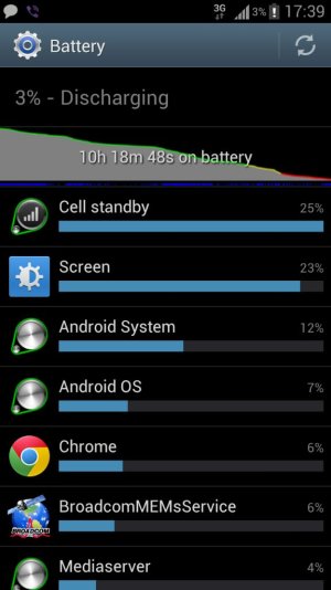

I know there are lot of screenshots but this happend to me today. I was just checking e-mail fb or g+ nothing serious. Wifi off, power saving on, bt off, gps off, 3g on. Signal good...
