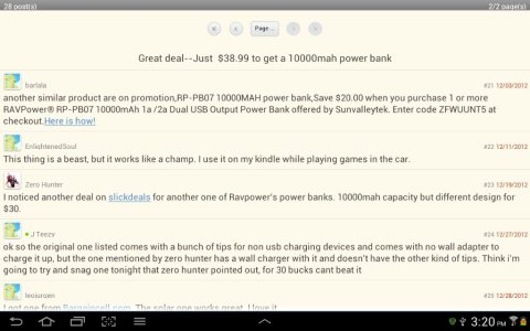

But you are connected to your pc and the tablet is on is there a red x over the battery icon like in my picture
