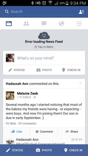

As you can see, Facebook gets no data on Wi-Fi. All of the other issues still exist, and this is after wiping the cache partition.

Another hard reset, no change. I guess it's not lollipop, it's my WiFi. Just bad timing, making it hard to diagnose. NO idea how to resolve this. WiFi is perfect everywhere else, including my Nexus 7. So, the Facebook app on another lollipop android device works great.
At least you know what the problem is now. It's your WiFi, not your phone.
