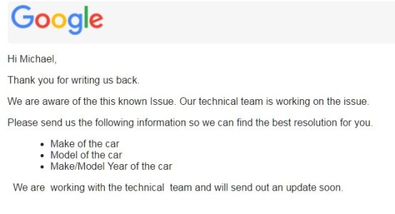

Posted in another Bluetooth thread, I got a reply from Google regarding my stuttering audio issues:
