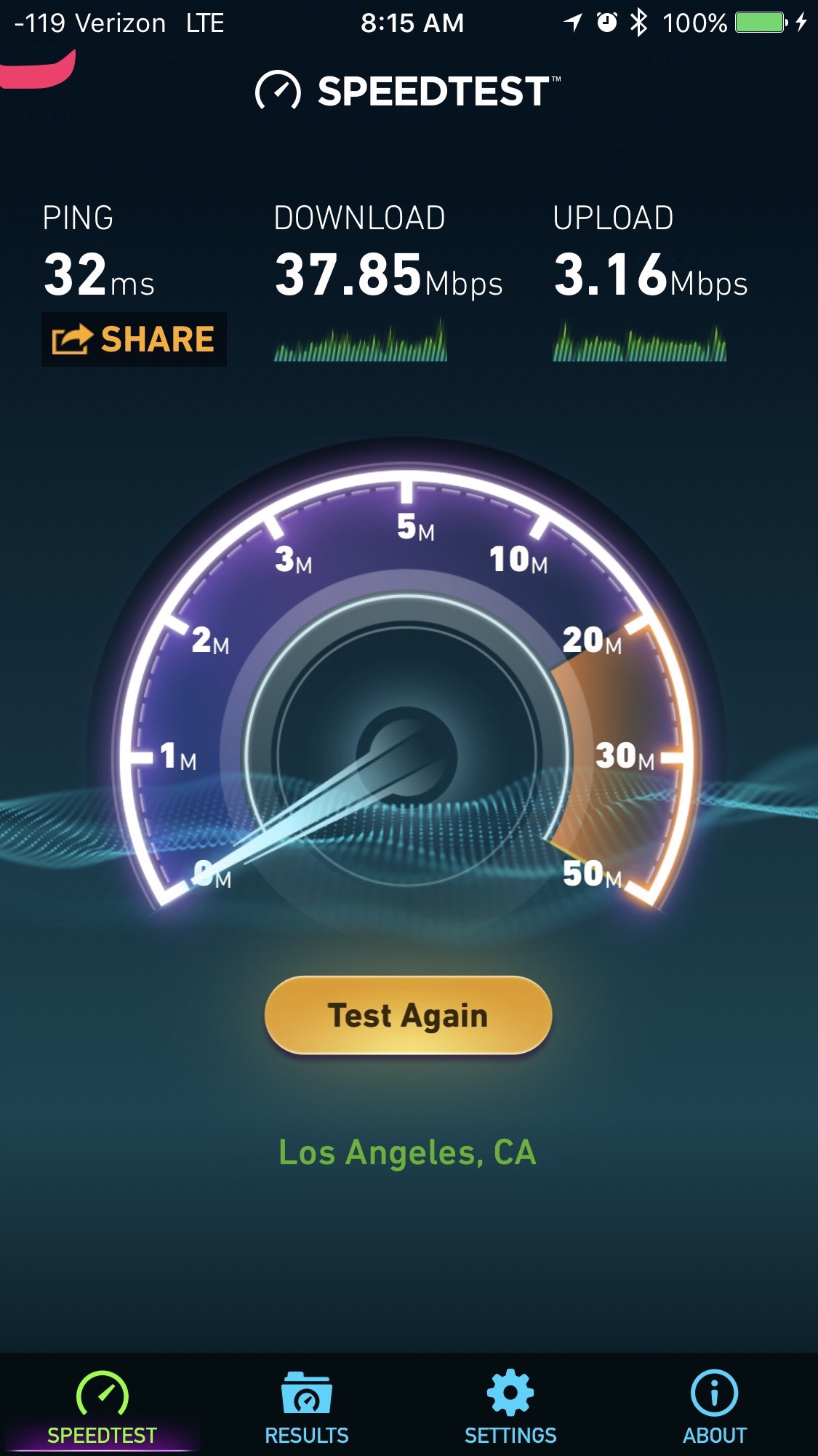

Signal strength isn't that important to me.... Even at -119dbm, i can still get good speeds
