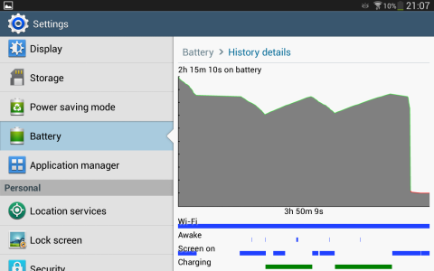

Thanks for your reply and warm welcome. The tablet is only 4 months old. I noticed yesterday that the other Note 8.0 we have (bought at the same time) is having very similar battery behaviour now, but with the battery consumption going UP by large amounts as well as down - very odd. I will post a screenshot later. My wife has a Note 10.1 that has what I would call normal battery behaviour, i.e. a steady decline over a number of days, so I know these 8.0s are not consuming power as they should.

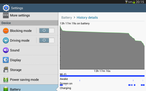

I'd read this this on another forum before you posted, but only left the battery disconnected for a few minutes. Even so the battery performance is so much better. Did this with the other note 8.0 we have and this time left it for an hour. Both are working a lot better now as you can see from the screenshot (mostly standby, but still a lot more hours use than before).
Seems a crazy thing to have to do though.
