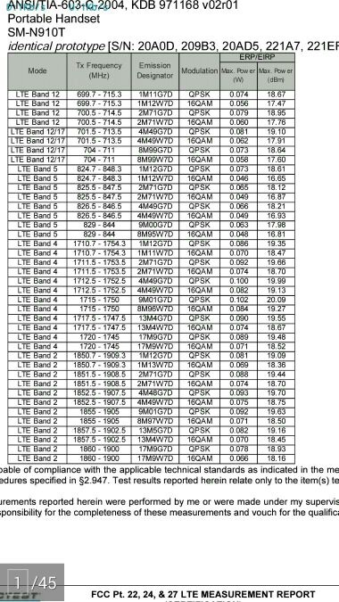

Thanks for the update... but what terrible news! Didn't the FCC filing show that Band 12 was officially tested for the T-Mobile variant? I wonder what happened here..
No, it showed it was tested for ATT and ATT's specs do say they support it. So it was assumed it would be supported by TMO's version and people also jumped to the conclusion that the two phones would be the same hardware since it is a TMO band. Don't know why ATT has it and TMO doesn't have it. I wasn't aware ATT even used that band.
Ah, thank you. I guess the FCC filing confused me too! What's weird is that if you go to:
h ttps://apps.fcc.gov/oetcf/eas/reports/ViewExhibitReport.cfm?mode=Exhibits&RequestTimeout=500&calledFromFrame=N&application_id=942994&fcc_id=A3LSMN910T
The website shows:
13 Matches found for FCC ID A3LSMN910T
But then all of the documents, such as this one:
Show SMN910A as the listed device, which led me to believe that the two models would include the same physical hardware but AT&T would probably just disable the Band 4 LTE... Either way, what a bummer but thank you again!!!

Hardware wise, the 910t(should be the tmobile Note 4)supports b12. It might not be enabled yet, and might be enabled via update, similar to how xlte was enabled on the note 3 after an OTA.
Fcc screen shot:
Att can use b12.as you probably already know, b12 consists of lower 700MHz blocks a, b, and c. B17 consists of lower 700MHz blocks b and c. Att has committed to MFBI for simultaneous use b12 and b17 on its network.

I'm guessing that means I can't use it with AT&T?
Yes you can. Att doesn't need b12,it uses b17 primarily and b2,4,and 5 in limited areas. It might not support all features like carrier aggregation though. And the tmobile variant would be sim locked, so you would have to unlock it for use on att.
