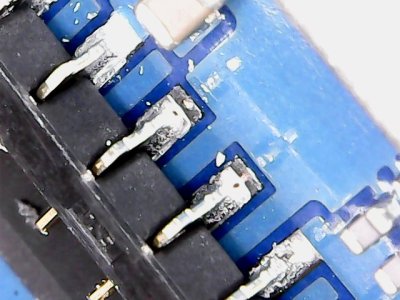

I've had my Tab 3 for about 2 years or so and recently when I go to plug it in to charge, it will shut down the tablet, like as soon as the charger is plugged in. I've tried 3 different chargers and they all do the same thing. It also takes forever to give it a full charge but the battery dies really quickly. I know this is an old (in tablet terms) device but I shouldn't have it shut itself off when charging or die after about 2 hours of usage.
Any idea would help me out! Thanks!
Batteries are based on chemistry. They have a finite life. Can yours be replaced? If your keeping the tablet I'd try that.
Re solder the battery connector will fix this problem.
Here is a cracked battery connector
