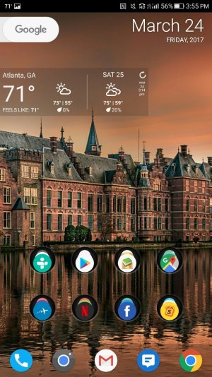

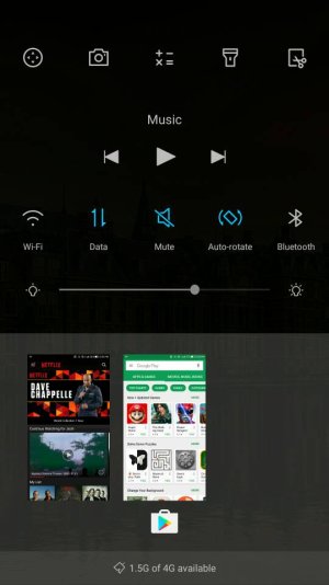

See attached. One is my typical home screen. The other is what I now see in the task manager. As you can see, the how screen is no longer an option in the preview...and when I press the home button, it just takes me to the app that appears in the left-most preview (Netflix in the example below).
FYI, great photo for home page.
