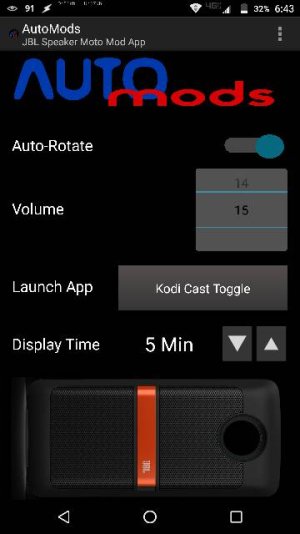

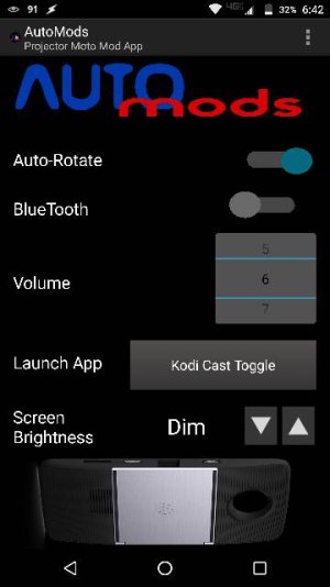

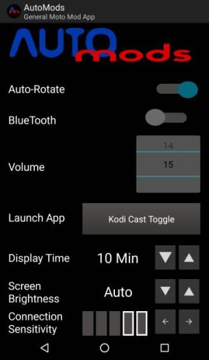

I haven't tried to make a tasker profile for this yet, but I imagine using an AutoApp plugin would do the trick... I'll have to play around w my projector mod and see if I can get tasker to recognize it... if not, maybe just making a Notification Action Button that launches your task you would want to execute when the projector is mounted could get you by till you find a trigger?

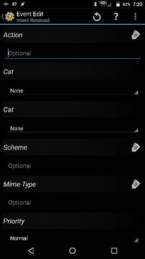

There is an Event Intent Received in Tasker! You wouldn't happen to know from your Tasker programming experience how to find out what to input into the fields? I guess I could look for some intent interception apps too. But maybe some dialog here can help others out?

I've tried several of the intents from the Moto mods developer page in the tasker intent receive event edit, but I'm not coming up with the right combination to elicit the notification I have programmed in the profile. I'm not even sure if tasker is capable to trying to detect the Moto mods this way at all (broadcast receiver vs action vs service).
This is the part of programming that always gets the better of me. I really don't know enough to make any real progress in Java based android coding. Every now and again I can find something somewhere that helps me get by, but in this case, I'm really just guessing as to what goes where. If anyone can shed any light, I'd be more than happy to learn.
