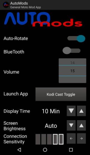

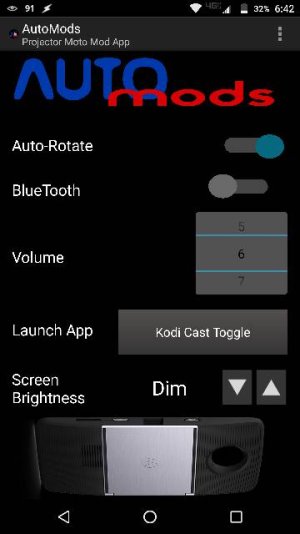

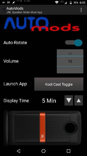

I've made and published an app that will automate various setting on your phone when you attach and detach a motomod to your phone!
What exactly are you detecting for that "Connection Sensitivity" setting? If you're detecting the electrical pins docking, shouldn't that just be a binary event? Are you relying on some external sensor somehow?
The app detects the change in magnetic field. Hence the sensitivity setting in the general AutoMods app.
