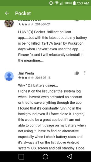

If you check out the pocket reviews, two of the current top 3 reviews are about battery hog issues.
I don't know their circumstances or what sort of testing they've done, but clearly this is something pocket is now aware of.

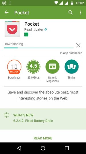

They are pushing and update to fix this battery drain.
