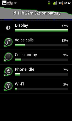

This is from about a week ago.
@wanda - did you try the built in Batt % gauge - it's on these screen shots.
  • Like
Reactions: Wanda
Thanks zeroneck and Pville. Thats the only real problem with this ROM...TOO MANY OPTIONS!! LOL! Didn't even know it had its own built in % meter.
