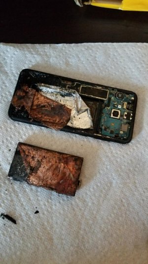

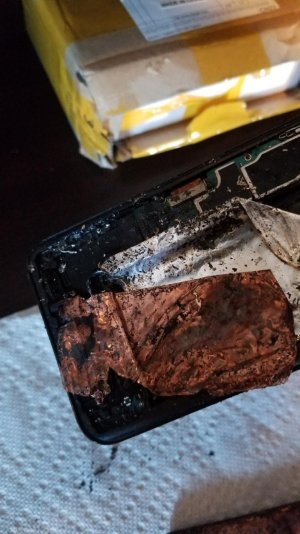

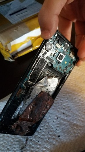

This is what happened when I used a playing card to remove S8+ battery
Why what? Why did it catch on fire or why did I have the phone apart?
I was replacing a cracked screen. Samsung made it accessible.

Yeah, there's a reason why these phones aren't meant to be taken apart. They glue everything and you bend a battery too far it will burst. It's what happens. No fault to the phone itself, more so towards the user who is attempting to fix something they normally shouldn't.
Lithium batteries are delicate little pieces of power.
It's best to at least be very careful. That's why when you see teardowns, they are very gentle when removing the battery.
well you blew 800.00 plus should of got a LG V20 with a battery you can take out
You better call the EPA because you have a HazMat site now rope off the area and call in the experts to dispose of this material,
Lithium ion batteries become exothermic when exposed to air. The playing card probably sliced the casing of the battery. Similar to a paper cut.
