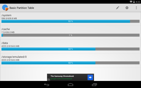

My 2012 Nexus 7 (16GB, Wi-fi) was acting sluggish after a routine upgrade to 4.23 so I attempted to use a factory image to restore it. It didn't have enough battery charge when I first attempted it so it hung on the OS load. Things got ugly--at one point I was getting the red triangle android, then it would just blink the Google logo over and over... at any rate, I managed to reload 4.23 and now everything works fine. EXCEPT, my free space is mostly gone. When I go into the Storage menu in settings, my "Total space" is 6.02GB. This is (was!) a 16GB model. How I can tell where the rest of the space went? Maybe there are two recovery partitions now?
Happy to send screenshots, run fastboot commands, etc., to provide more info if needed.
Side question: My bootloader version (after the shenanigans above) is 4.23 (even though my original android version was 4.22). I recently upgraded to KitKat and the bootloader version is still 4.23. Normal?
I had the same problem, flashed 4.4 & only had 6.2GB Total storage showing. Like my N7 thought it was an 8GB model.... I Tried Everything.. Factory reset, Soft Boot, Battery pull, Reflashing 4.3 & 4.4..... Finally I tried relocking then Unlocking the Bootloader - Problem solved ;)
Edit... 4.23 is totally up to date so you're GTG on the Bootloader version :)
Thanks! That worked. The unit is still sort of FUBAR under the hood (for example: fastboot devices shows "??????????????" instead of its serial number; I cannot re-lock the bootloader again because it says "too many links") but at least I have my 13GB of storage!
