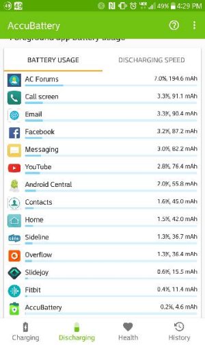

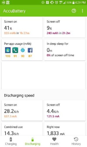

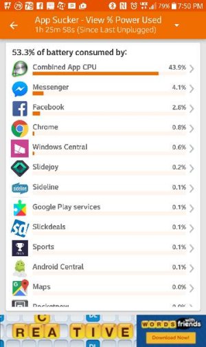

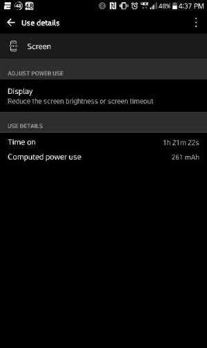

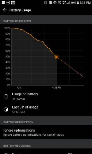

I wish I could figure this out. I switched to another battery...... GPS is set to battery saver.
I guess next stop will be fb. I feel like it's Android that's sucking it

What screen brightness do you use? Screen is always the biggest drain. If you are 80% or above , that does start to drain quick. 60-70 is good for me, unless i'm outdoors.
