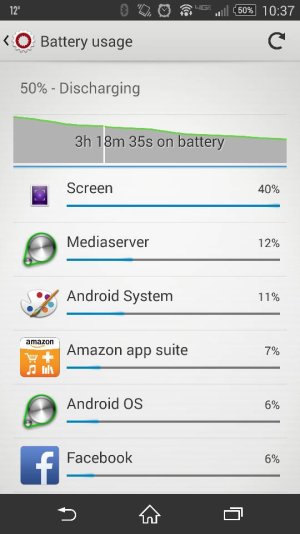

Can you please post battery use screenshots?
What you are experiencing is not normal at all.
Of course after I wrote this, I have a decent battery day. I still would like a better battery life though.

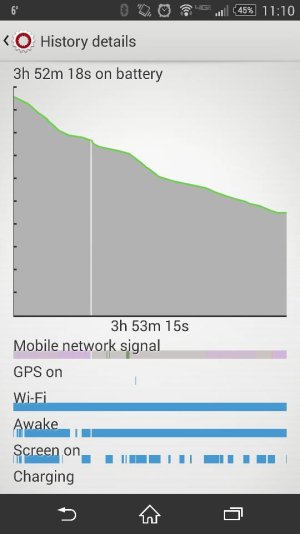

Can you also provide the more detailed view by tapping the graph? Also curious what your screen on time is... tap on screen.

Hope this helps. It seems to be better today.
Something is keeping your phone awake when it shouldn't be and that amazon app suite is pretty high on the list.
What does the "App Power Consumption" in your Battery settings say? Also, do you live in a place with a constant weak signal?
