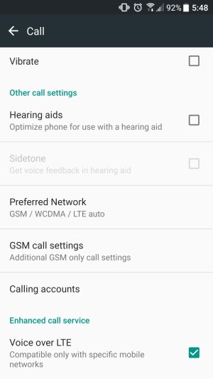

It corrected itself. After installing Nougat it said changes were made and the phone needed to reboot. After rebooting VoLTE was back under phone settings and turned on. Phone call confirmed.

Would you post a screen shot of where to VoLTE is found on the phone. I'm on AT&T and do not see the option. Thanks
