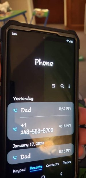

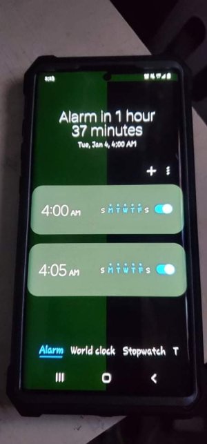

So here is an example of the strange things that keep happening to the screen. This was the middle of the night.
I think I found out what the issue is... I called a local phone repair store and he knew exactly what I was talking about. He said more than likely one of the connectors inside the phone isn't on correctly. If it's that, only 40 bucks to fix.
If he has to replace to the display... It would cost 300 dollars. Yikes. I will not be replacing the screen. For 300 dollars, I can get another Note 10+ with no issues or another device entirely.
Small update... So I took my phone somewhere else and it appears to be fixed. I really couldn't get a completely straight answer other than when they took it apart, it did something in the software.
