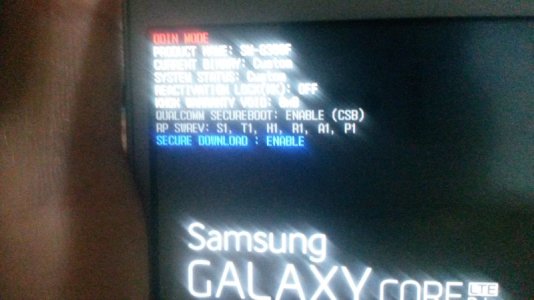

I have an older Samsung phone model Galaxy Core SM-G360F which I didn't use for several years. Today I wanted to use it again, but I can't remember the password that I set up on it years ago. I decided to do a factory reset, but alas, for some reason I am unable to get the recovery menu with the usual key combination: Volume UP + HOME + Power On. If I keep these three keys pressed, the phone turns on and displays this menu:
Please note that there is nothing below this text except the Samsung's usual logo. Here is a picture where I tried to catch the entire mobile phone's screen:
I don't know why this "Odin Mode" appears instead of the recovery mode from which I could select Factory reset?

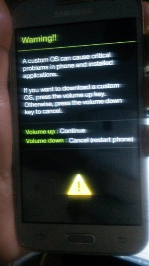

If I keep the following 3 buttons pressed: Volume Down + HOME + Power On, I will get the download screen like this:
and pressing Volume UP leads me to something that also seems to be some form of Odin Menu. But I can't choose Factory reset from that menu either. If I press Volume Down at that point the phone just restarts itself.

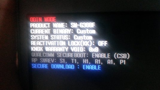

I am able to get into the download mode when I press Volume down + Home + Power On, and this is the screen that I see in that case:
But I don't see any info about the firmware version on that screen?

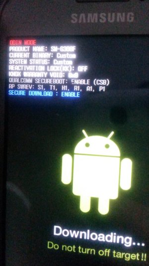

This is the next screen which I get when I press Volume Up (Continue). It looks just like the screen I'm getting when I press Home + power on + Volume Up in the first place, but it has also the android robot below saying "downloading... do not turn off the target".
I don't see the firmware info on this screen either.
Yeah , it has a custom one already on it
You can't get into recovery correct?
No, that's the problem. I get the same text in both cases, when I press Power on + Home + Volume Up AND when I press Power on + Home + Volume Down (then volume Up to continue). In both cases it doesn't give me the option to choose Factory reset.
