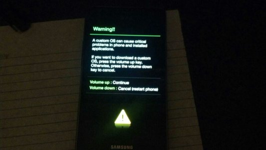

Are you in recovery mode or download mode? You need to be in download mode for it to work! That is download mode on am s2, same basic idea as s3...
Look up for the s3 how to get into download mode, but for the s2 you hold down both volume buttons while connected to USB and it goes into it. I think it may be the same on the s3. If you are I'm fact already I'm download mode not recovery then this isn't your problem, but if you are in fact in recovery mode and not download...then that's your problem. Odin can't recognize a phone that's in recovery mode as far as I know.
Sent from my DROID RAZR using Android Central Forums
