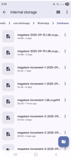

I’ve since gone back to my old device (Samsung S23 Ultra) and located multiple local backup files in the path:
Internal Storage > Android > media > com.whatsapp > WhatsApp > Databases
The files look like:
  • msgstore-2025-09-12.1.db.crypt14
  • msgstore-2025-09-19.1.db.crypt14
File sizes are around 114 MB for the main backups, so they appear intact. (but small for 20 years of messages even if just the text)

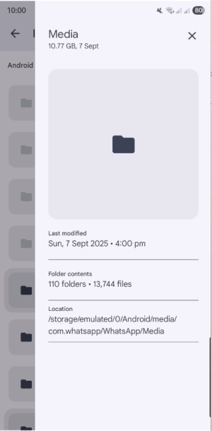

I still have over 11 GB of WhatsApp Media (photos, videos, voice notes) and the database files on the old phone S23

Thanks SpookDroid and Mustang7757, I just read my orginal post, What if all the files were still present on the old device, eg: I had not copied from the new device to old, but trying to restore from the files existing ?
Does a backup file of 100MB with a date from 4 days ago seem a little small being it would contain the text from messages over a 20 yer period of a heavy WhatsApp user ?
Any help on this one would be really apprechiated, Im trying to help a user that has really mucked up when transferring to a new device.

Even if the original files are in the old device, they are not accessible unless the Whatsapp account (i.e. number) is logged in on that particular device. The files without the login are useless outside of Whatsapp. Unfortunately, and this is by design, the only way to restore those conversations are through Whatsapp, on the exact same device the back ups were generated from, and logged into the exact same account that generated them. As for file sizes, it varies but because these are heavily compressed (media is stored separately), 20 years of texts may not be too far off (that is, of course, provided said 20 years were already present in the old device).

Thanks so much SpookDriod,The files are on the orginal device (they have not been moved or copied), and he is using the orginal number that was on the orginal device, yet when he reassings the numbr on the orginal device (S23) the messages are blank (they are there just no data in them) and it at no point promts him to restore from local backup when he reinstated the number on the device, only from Google cloud, which it says there is no backup which is correct. Ive even tried skipping the google restore part putting the phone in Aeroplane mode to force it to look locally. Any ideas how to force the local back to be reinstated.. its definitly the orginal files, on the orginal device, with the orginal number now back on the S23. I worried this will all become invlaid in a few days as the backup only stay for 7 days on the device.
How did he reassign the number? If he chose to restore from another device (the new one), the 'old' back up files become invalid. Again, these are encrypted and not even Whatsapp/Meta has the 'keys', which are generated on-device. If the key to teh original files has been replaced, then those files are now unreadable.
