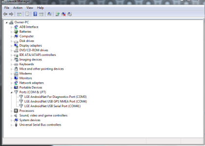

5. Now go too your device manager and look for your com ports and find your LGE Android USB Serial Port. Now double click it and look for advance and then click it. now we have too change the com port too 41. when you are done press ok and close it out.
